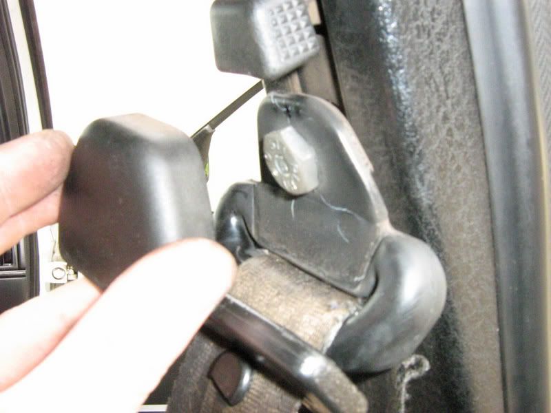

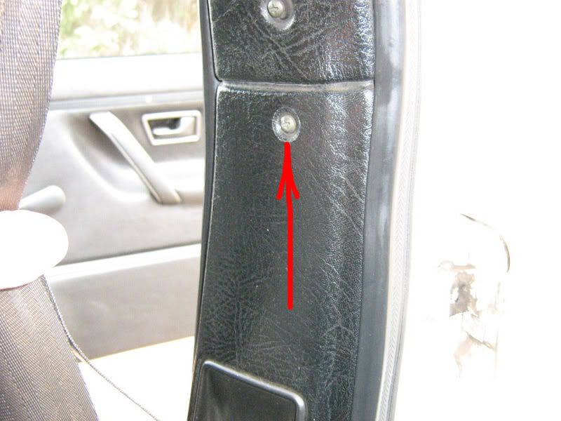

First, pull up the plastic peices covering the screws, remove screws. Remove screw on the top of the seatbelt cover as well:

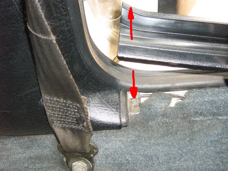

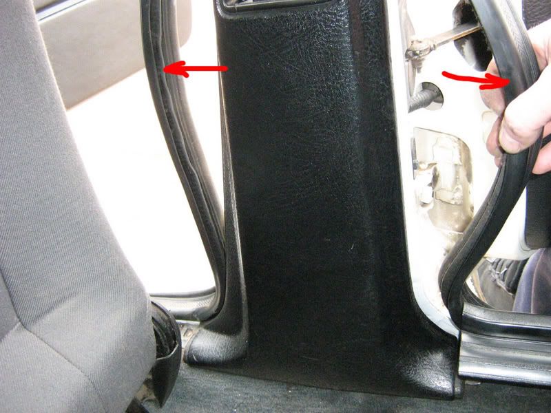

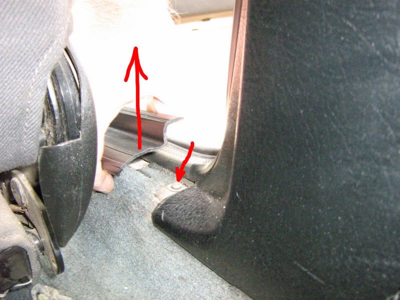

Pull back the door rubbers:

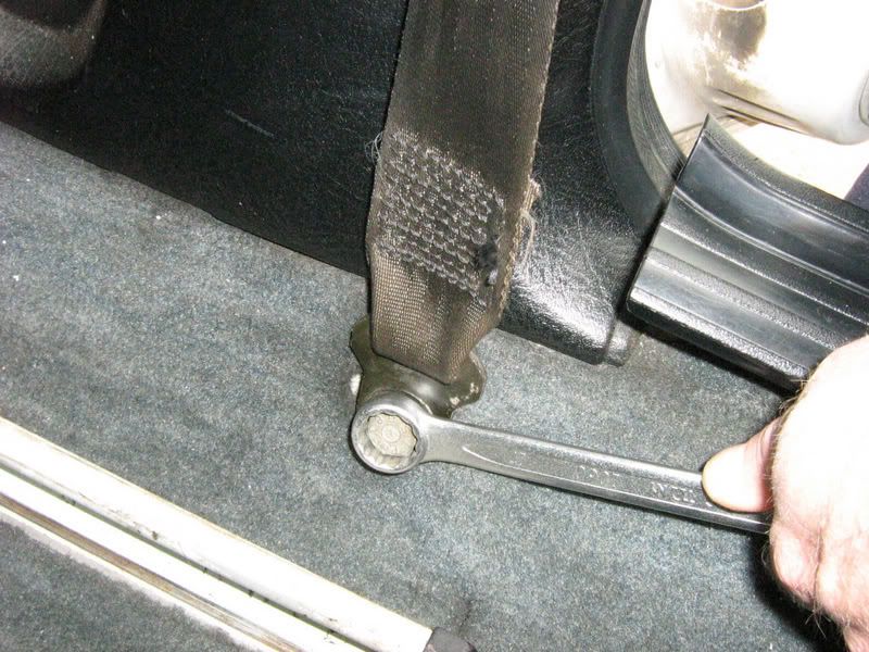

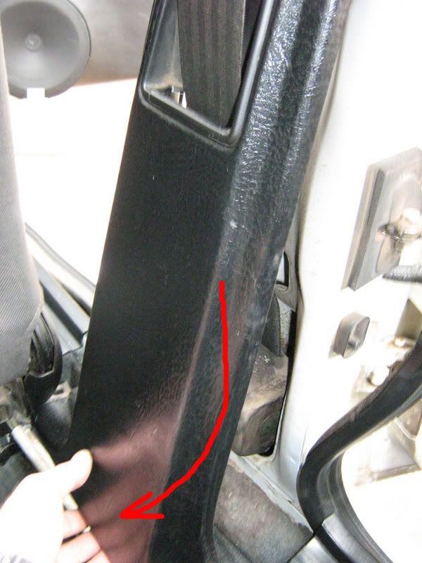

Remove the bottom bolt for the safety belt and remove the plastic cover by sliding it a bit downwards and pull it out the way:

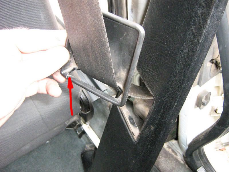

Take the small plastic cover out of the seatbelt cover and pull it off the seatbelt. It has a small split in the one corner to make it removable:

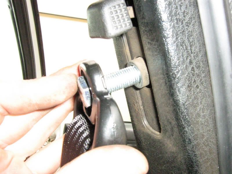

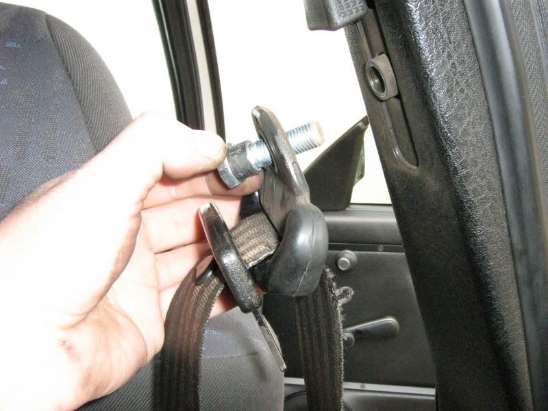

Pull off the cover from the top bolt, remove bolt and pass the belt through the plastic cover:

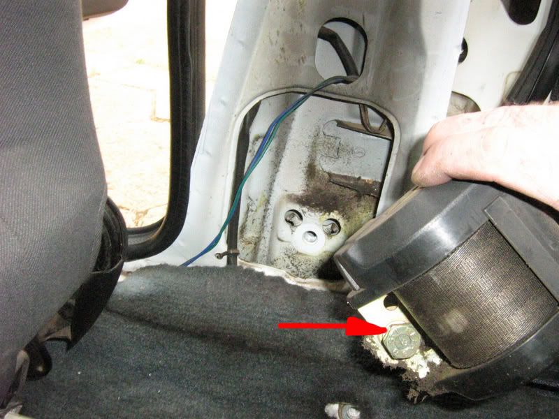

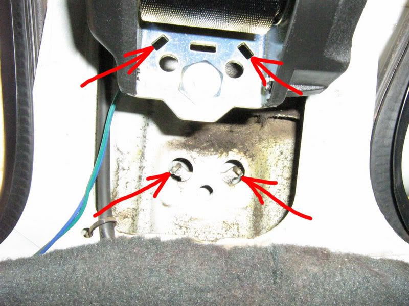

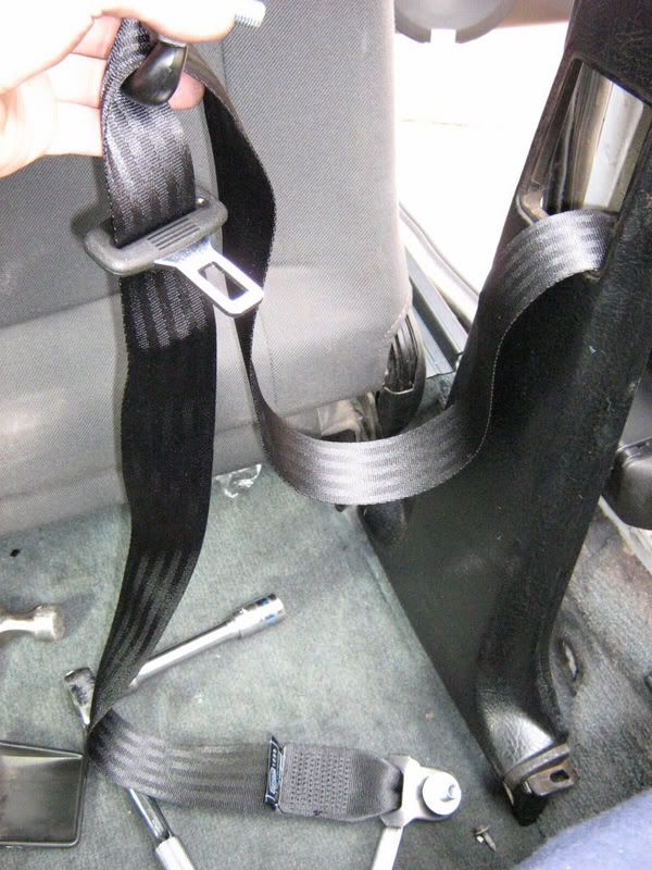

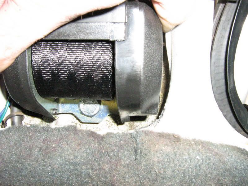

Put the plastic cover out the way and then remove the bottom bolt holding the belt mechanism:

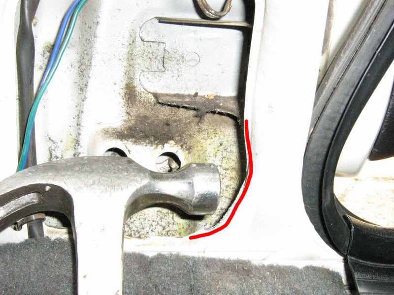

Take the hammer and knock this area a bit so the new belt can fit. The Velo mechanism is slightly wider on one side than the original one. This "mod" only has to be done on the driver's side.

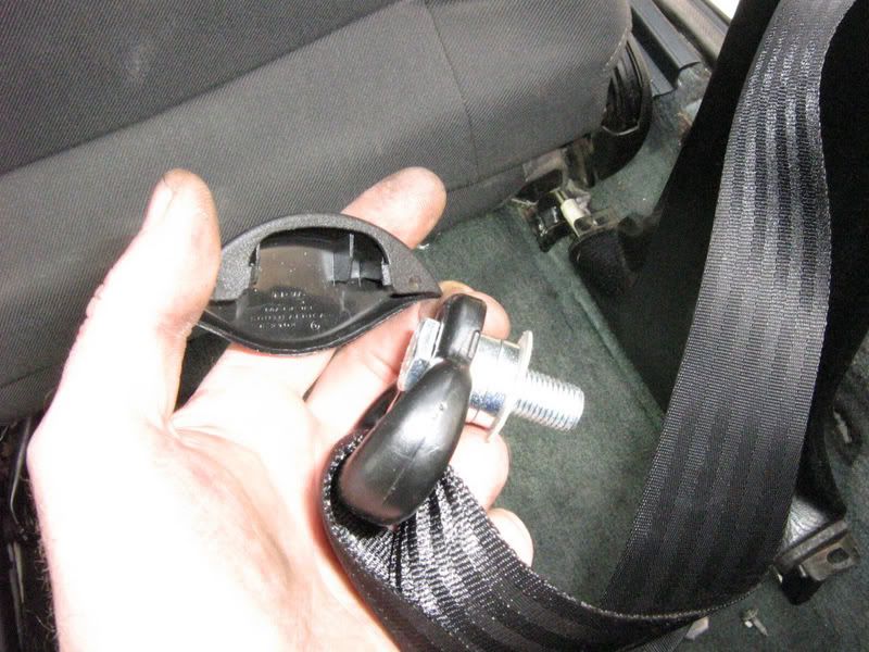

Take new belt and put it in place. Make sure the little tabs on the chassis go into the grooves on the new belt.

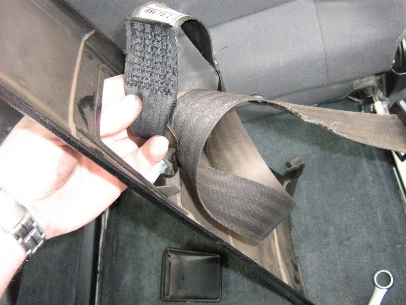

Feed the new belt through the cover:

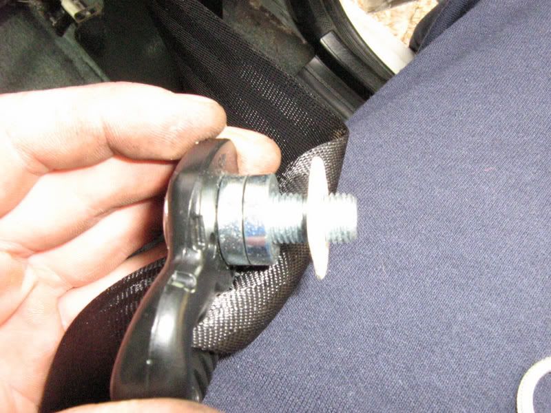

Now for the second "mod". Take the bolt cover off the new belt's top part.

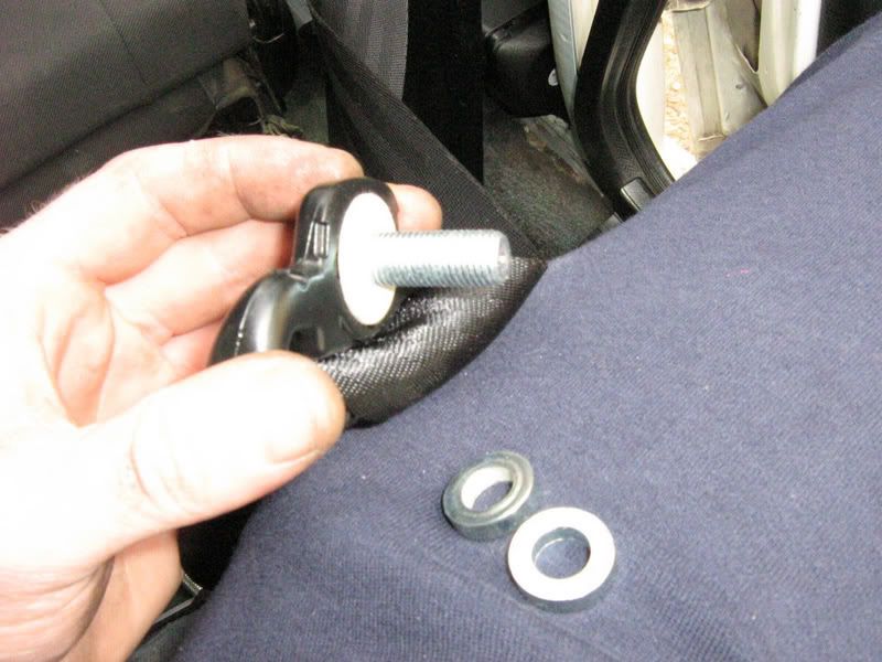

Take off the paper washer and the 2 metal spacers.
Put paper washer back on and tighten up:

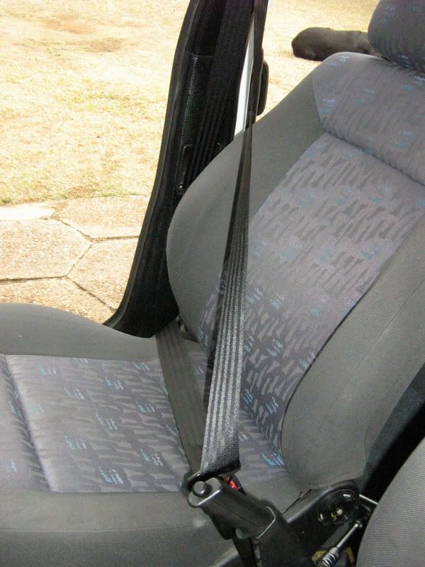

And it is done.
Time taken for both sides: 35 minutes.
