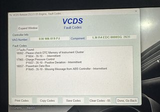

VCDS picked up the following errors

Update on this issue. It has been fixed. There was a problem in the wiring loom that goes from the fuse box to the ABS module plug.
One of the wires that was supposed to supply 12v was reading -3 basically dead. Provided auxiliary power by joining that wire to the battery and bridging it with a 10A fuse. Works perfectly now :thumbup:
