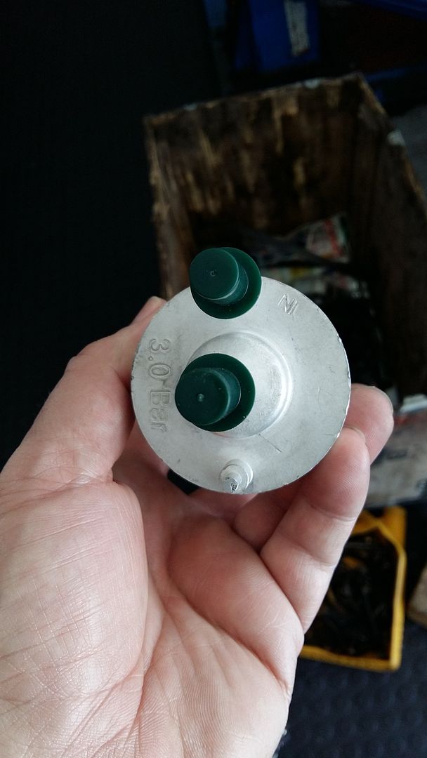

Should look like the pic below:
On the side with the two pipes - the top one (in the pic) marked 'IN' comes from the fuel pump, the centre one is the return back to the tank. The single pipe on the other side is the feed to the engine, goes onto the fuel rail.
