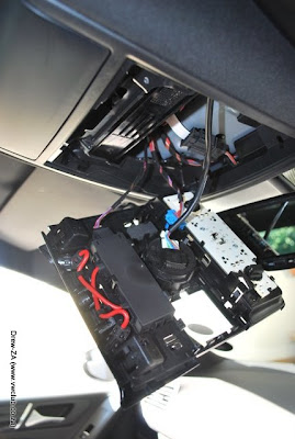

Remove the sunroof and map light control panel trim:
- Use your trim removal tool and ease it under the trim of the sunroof control panel. Work your way around it and the clips should just pop out.
- Now do the same with the map light panel. This panel is a little more difficult when you get to the red L.E.D lights. There is a clip there that needs to pop out. Once it has popped, the panel should just come loose.
- Now move onto the security panel. This panel only has clips in the front section. It then swivels down as per the pictures.
- There are 2 torx screws that need to be removed for the panel to come out of the headliner. The panel is held up by the wiring. You can leave it hanging down for now.
- Now remove the right hand side fuse panel. It has 3 clips holding it on (bottom, middle and top). Use your trim tool and just pry it off. Then move onto the middle section of the A-pillar. Simply pull it up from the top and out as per the picture.
- Now unseat the right hand side sun visor. Simply pop the screw cover open with a small screw driver and then remove the torx screw. The sun visor will then come loose and will hang from its wire - leaving it loose for now. To make your life easier, also remove the right hand side handle, this allows the headliner to move more when you have to feed the mic wire. Simply pop open the screw cover, remove the 2 torx screws and then wrestle the handle loose.
- Now remove the top A-Pillar section as per this post: http://www.my-gti.com/1867/volkswagen-g ... stallation. Be careful of the "Airbag" logo as the clips can break easily. You will need a small screw driver to pinch the clips under the logo together. Go slowly and use a torch here.
