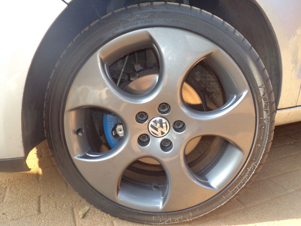

mine are ATE, but all for 256mm polo 9n3 look like these, BUT NOT GTI & TDI
Notice the three shiny spring tabs. Unfortunately rim is in way of the spot that calliper moves and hits.
a pic from readers rides:
